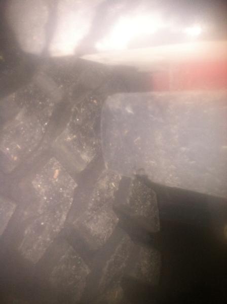

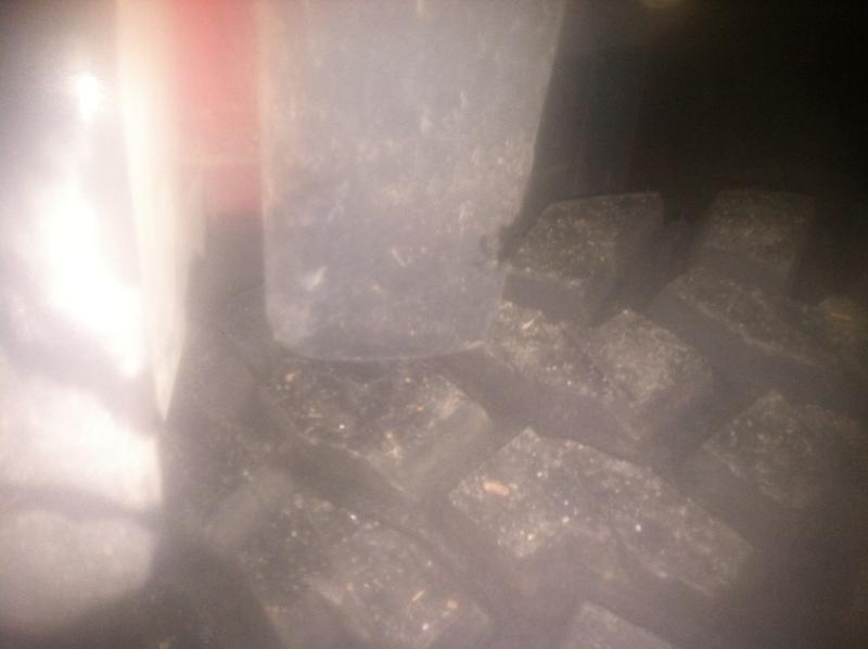

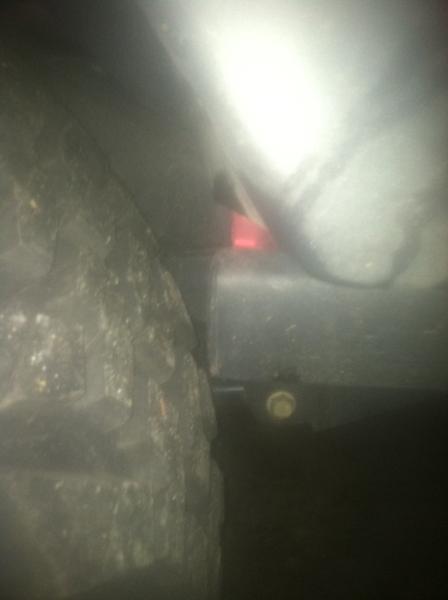

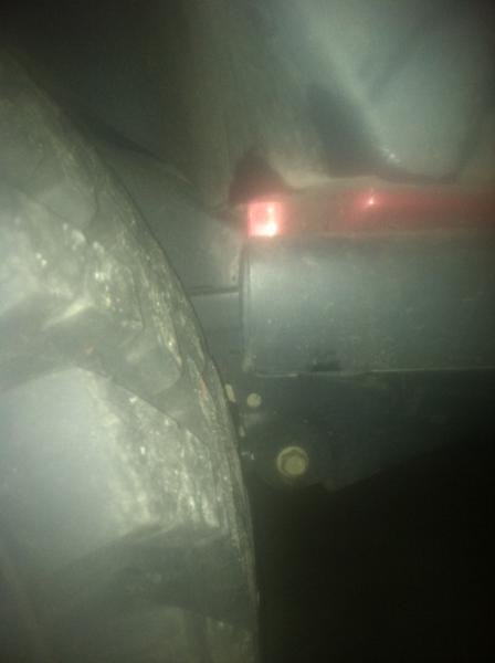

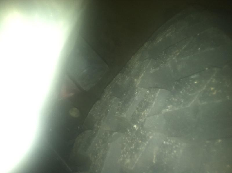

Just lifted my jk an got 35x12.50/17... I was wonder if anyone had these rub there back tires at all cause mine are bout one inch from the rock rail... I'm wondering at flex will these hit my tires I dont need a punctured tire or a big chunk taken out of a new tire...
I'm running trail grapplers... I don't have anywhere to test the flex except out on the trail an id like to find out before I go out so I can trim em

Old Oct 13, 2011 | 01:28 PM

Name:	rock rail 2.jpg
ID:	223091Click image for larger version
Name:	rock rail 3.jpg
ID:	223092Click image for larger version
Name:	rock rail 4.jpg
ID:	223093Click image for larger version
Heres some pics of my rock rail on my jk

Based on other forum member's suggestions, I cut my Rubi Rails back 2" and the pinch seam 2"

Yea from what it looks like on mine im going to have to so i dont rub on the tires

I'm running 2.5 - 3 inch lift with 315/70R17 so almost 35's and at full flex with 2" bump stops I have about half inch between rail and tyre but doesn't touch.

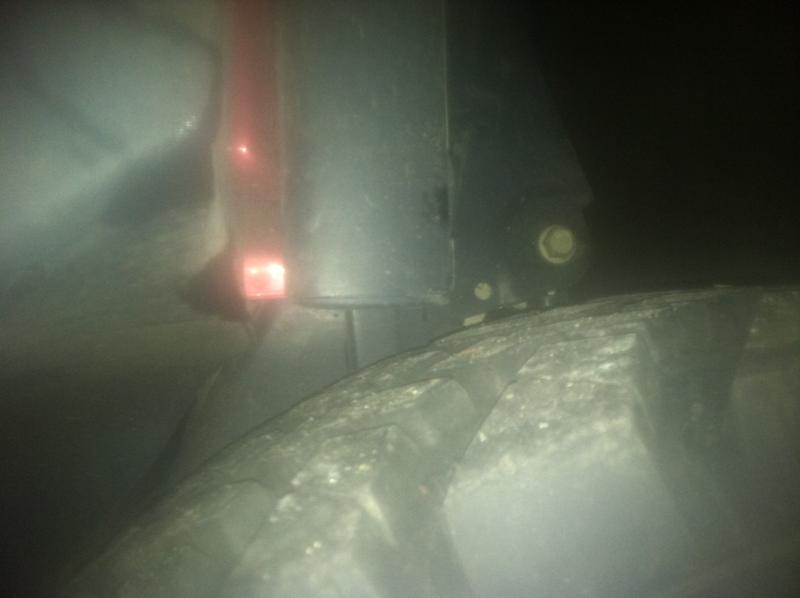

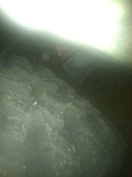

ID:	223100Click image for larger version
ID:	223102Click image for larger version
ID:	223103Click image for larger version
heres a better view of the pics i had to turn them right side up
yea im running RK 2.5 coils an TF shocks an im less then a inch an that just sitting on level ground

Yup - if you're running a relatively short lift, you'll want to trim 2 inches from the rock rails, and trim or bend the pinch seam by the same amount.
