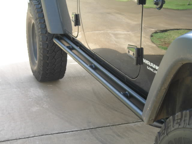

If you are talking about the Mopar Enhanced Rock Rails you might find it necessary to trim them down in the rear if you get your Jeep flexing much. When I had mine, my rear passenger tire (35") would rub the rail when it was fully stuffed.

Well I actually swapped mine out before trimming them. I have read of quite a few guys doing it though. The end caps comes off, trim it to your liking, sand it, paint, put the end cap back on. I think I would have removed them from the Jeep before doing it had I trimmed them. Removing them was actually really easy.

Yes, I have a Rubicon X. It came with the tubular ones you are talking about. I traded mine for some Poison Spyder Rocker Knockers. Other people on this forum and the Wrangler Forum have trimmed these before. They usually trim so there's a half inch or so hanging past the tube.
