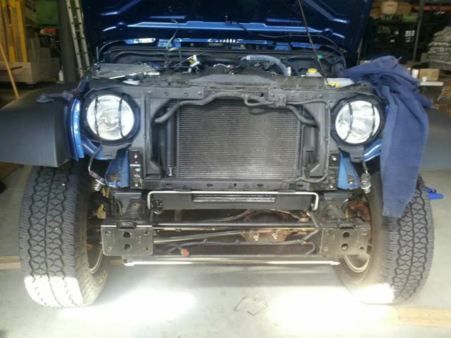

Are you referring to the oem cooler they claim is for towing? I believe it's the same one that comes in the 2012's and up. That's what i did and while mostly useless it not that difficult. The hardest part is removing the transmission lines to swap in the new piece. There's a special tool for that. Also there is a plastic dam or something that comes out as well. Removing the grill and bumper are a must.

Bumper removal is not required.

blue project's Avatar
Posts: 1,531
From: Cape Cod
