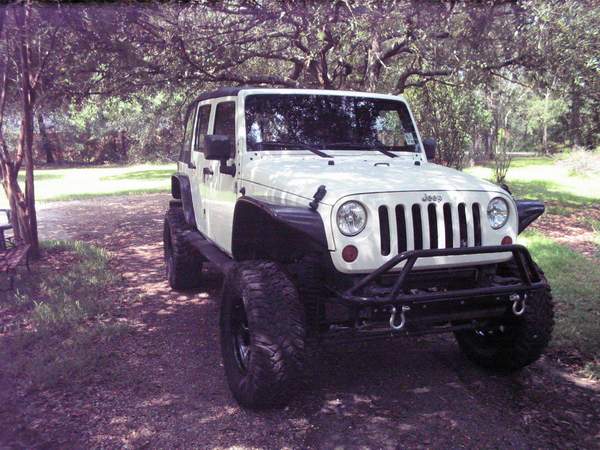

I'm running spidertrax w crager rims that have 4.5 BS My totlal BS is 3in. Only thing I see failing early on this setup is the wheel bearings, but imo , anything less than the stock bs is gonna stress the bearings more, so I guess it's up to you, I like the look and stability myself.
