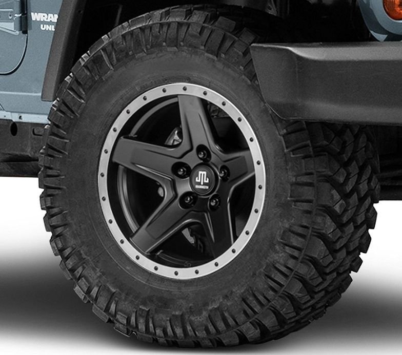

These are the wheels Im looking at. I looked at alot of sites and most 17x9 non-beadlocks are 12mm offset max. I did look at dirtylife wheels and It looks like they are 12mm as welp for that size and tbh the wheels arent my style. Im always looking at more vendors though! I definitely dont want to run spacers unless I absolutely have to.

I know the Dirty Life DT-1 and DT-2 wheels come in -38mm offset (3.5" BS) and they are a dual wheel that can be used as a beadlock or traditional mount. But, wheels are subjective to taste. I actually like the look of those and had tried to buy some at one point. That was a cluster F of availability of wheels, then beadlock rings, then returns. If you go with a 12.5" wide tire, the rear should be ok with the 4.5" BS on most wheels. Up front you would have a small clearance issue with turning radius and clearance at the frame rail. You may be able to just limit the steering enough with washers in the steering stops to prevent that. I really can't recall. I do know at one point i had 37x12.5 tires on 4.5" BS wheels and I got by. I might have rubbed just a little bit cuz I then saw some spidertrax for sale around me at a bargain price and slapped them on. A netted 3" BS was pretty aggressive look, and didn't do much to help ball joins with that kinda leverage.

I have the Dirty Life DT-1 9303 Dual-Teks on mine and they have 3.5" backspacing. These wheels you can run as either a traditional wheel and use the plastic trim ring, or, you can do what I did and get the aluminum race ring and run them as an actual beadlock. I have had no problems with them what-so-ever.

Those wheels actually look a lot better on a jeep than In catalog. Interesting. I still feel visually weirded out by the logo making the beads look Un-even, but i suppose the option of blacking those out is still there. Great looking rig man.
Looks like i definitely was not looking hard enough for the right offset. Ill keep at it.
