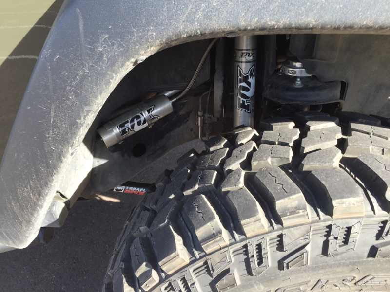

I'v got some JK 2.5"-4" TeraFlex Tuned Fox Reservoir w/Adjuster shocks in the mail supposed to be here on Wednesday. Coming direct from TeraFlex and was wondering where everyone is putting their reservoirs.
Some people Just stack them next to each other. (Leaning towards this)
Some people Mount them inside the fender at the top. (Not a fan may Rub)
I'v seen some put into the engine bay for the fronts. (This might be a good option)
My main concern is clearance. I don't want to rub on them or put them in a spot that might get hit by rocks etc....
Anyone have pictures of where they mounted them and why they did it that way?
Old Apr 8, 2016 | 03:11 PM
afpilot82's Avatar
Posts: 2,150
From: Cheyenne, WY
Fronts mounted to the frame.

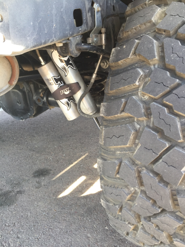

Rears are connected to each other with the supplied Fox bracket.

Fronts mounted to the frame. <img src="https://www.jk-forum.com/forums/attachment.php?attachmentid=643178"/> Rears are connected to each other with the supplied Fox bracket. <img src="https://www.jk-forum.com/forums/attachment.php?attachmentid=643179"/>
No offense, but both of those would be my exact last choice.
Old Apr 8, 2016 | 03:50 PM
Jonathan_JK's Avatar
Posts: 2,203
From: Jacksonville NC
I looked in the rear there is not a good option for them so I'm going to double the rear unless someone has a better Idea.
