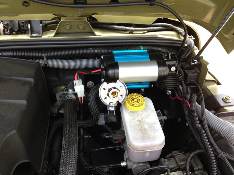

EVO mount and hood struts work fine together
