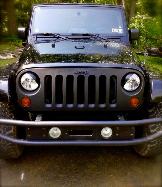

Using this bumper how would i mount a winch do i need a plate or something? i purchased the jeep with this bumper on it. i was going to do some custom fab on this bumper, and keep it for awhile untill i decide to get something else. to me it looks like i would need a plate ,and my cable would go threw that hole but i dont know.

It looks like an Olympic Boa bumper:
230 - Boa Basic Bumper Jeep Wrangler Jk 2007 to current | Olympic 4X4 Products for over 60 years
I think you need the Olympic 507-174 winch plate.

That looks exactly correct thank you very much
