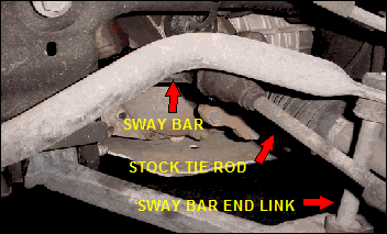

The drive side tie rod is simple enough:
The issue is with the passenger side tie rod. There is little space to do it because of the upper knuckle:
I was going to give it try by using a new, specially-bent bulletproofsteering.com tie rod with rod ends and bolts. I was going to replace the rod end on the drag link for a bulletproofsteering one with the bolt upwards. I was hoping to gain some space between the two knuckles
