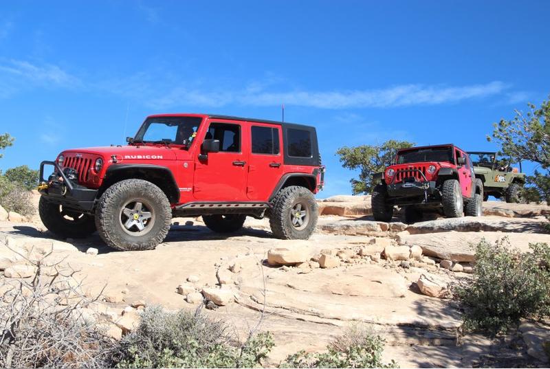

you can run stock rims or aev pintlers but you will need spacers for 37's. I had pintlers and 37x1250's and they rubbed the shock reservoir in the front and sway bar links in the rear, slapped on some spacers and i was good to go.

only rubbed in the front offroad and and in the rear during normal driving, had to run shorter end links until i got the spacers (limited flex).
