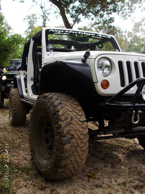

Old Nov 27, 2009 | 07:43 AM
mkjeep's Avatar
Posts: 15,665
From: Hammond Louisiana
toyo's got my vote
