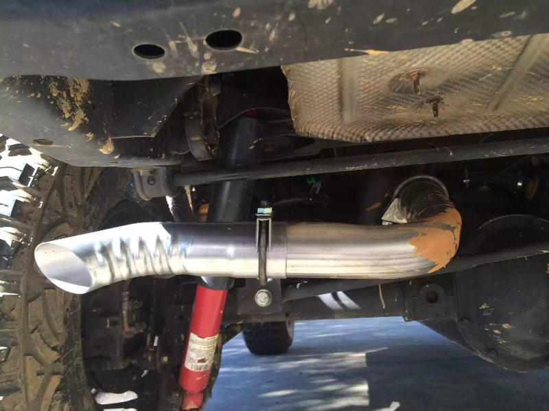

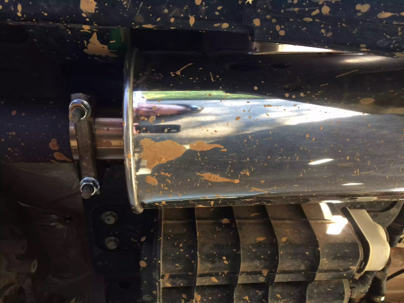

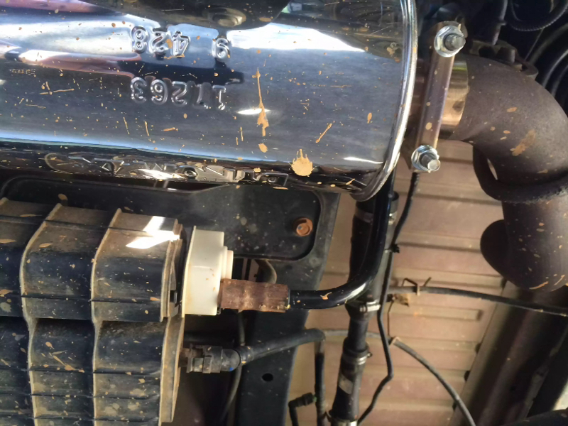

I think you have a few options depending on how much work you want to do. The easiest is removing the stock muffler and placing a dynomax vt muffler in its place. This is slightly louder than stock and you can tuck it a lot farther than stock. I had this setup for a while and eventually wanted a little more rumble. I bought a dynomax round muffler and cut into the stock exhaust pipes that run along the drivers side of the jeep. I clamped it on and with a couple of generic muffler pieces from auto zone I made this work. More rumble and no drone. Not obnoxious at all. Both setups ran me about $100-120 each.

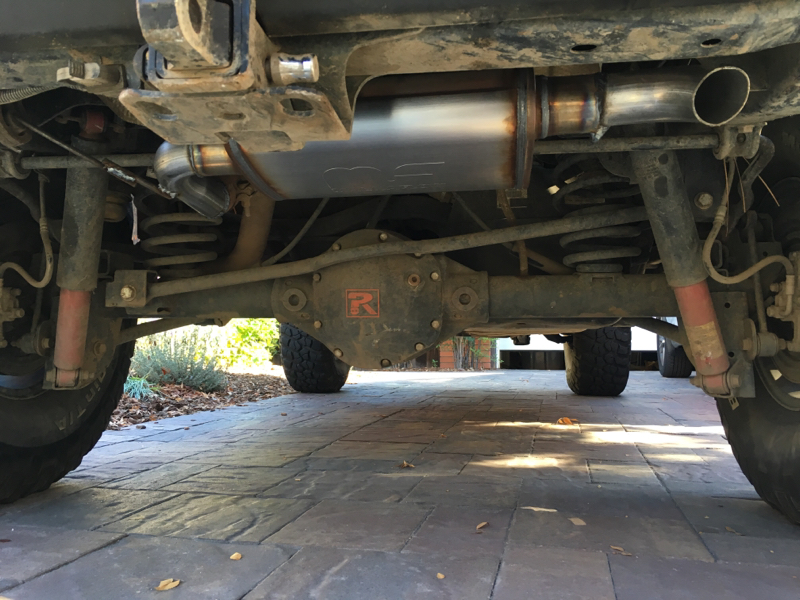

Magnaflow where the big can used to be. Not pretty but it's in there

Originally Posted by orangedude71
Attachment 631484
X2 for the Magnaflow
And yes, you can just thoroughly clean it, then brush or spray it with mat black high temp' stove paint to make it pretty much disappear.

Nice relocate!
For knowledge the PN on the muffler is 17263 this is our 2.5" I/O round Ultra Flo Welded stainless steel muffler.
It has an overall length of 20".
Attachment 631478
Attachment 631479
Attachment 631480
