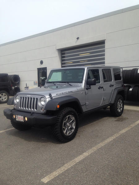

I have finally gotten to the point where I can begin the build up of my Jeep. I have been stockpiling all of my parts over the last year. I had planned on doing this to my 2012 Sahara unlimited but I just traded it in for my new 2014 Rubicon unlimited yesterday! I figured instead of beefing up the front axel and D30 of the Sahara ,as well as adding lockers, I'd just trade it in for the Rubicon. My payments basically stayed the same anyhow.
The best part is when I pulled in the driveway yesterday afternoon with my new Rubicon, the UPS truck was right behind me delivering my new 37" Nitto Trail Grapllers!

Alexjeepvb:
thanks, I'm pretty happy with my choice. I like having the factory lockers and swaybar disconnects now. I'm going to get this thing built next weekend and don't plan to wheel too hard in the next coming months. So, I should be fine with the stock C's and axel tubes for now. I will eventually instal the axel truss system that Northridge4x4 offers someday though.
