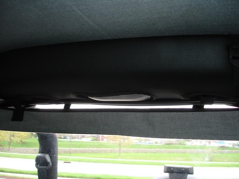

3. There are some gaps that this top leaves near the doors and towards the top of the win jammer. here are some pics.
above the drivers side door
side of drivers side door
top of wind jammer
over all look
what did everyone else do to fix this gaps. I figure the wind jammer will stretch a bit and the gap wont be so big. I saw some pics on here of someone who had additional fabric added by someone who does some stuff with boating material but i cant remember who. That seems like it would be expensive. Today i think I may try to use some pipe insulation and fill those gaps a bit attaching it with velcro straps. Any thoughts?

windjammer= I am 6ft 1 and do not like having to sit at a 90 degree angle, the jammer is not designed to cover the entire area so if you are looking for weather proofing put your hardtop or soft top back on, it's made for what it is named.... windjammer
bikini = it blocks the sun and light rain, it helps to have the door frames and connect it to the channels around the top as opposed to strapping it to the roll bar, it flaps a little but hey so do sails on a sailboat, tighten your straps down after the first application and also when it is hot
duster cover = love it no complaints at all, stretch it prior to install as some folks here have dimpled the body near their beltrail.
gaps= only the top of the windjammer has a 1 to 2 inch gap between the soudbar and jammer when installed. If you have the door frames installed you will have only the distance between your rollbar and doors (if on) to deal with..

as far as the windjammr goes, bestop makes a wraparound jammer that fits tight and doesnt allow water in.
Im pretty sure you need to get the door surrounds that come on a soft top jeep to close up those other gaps

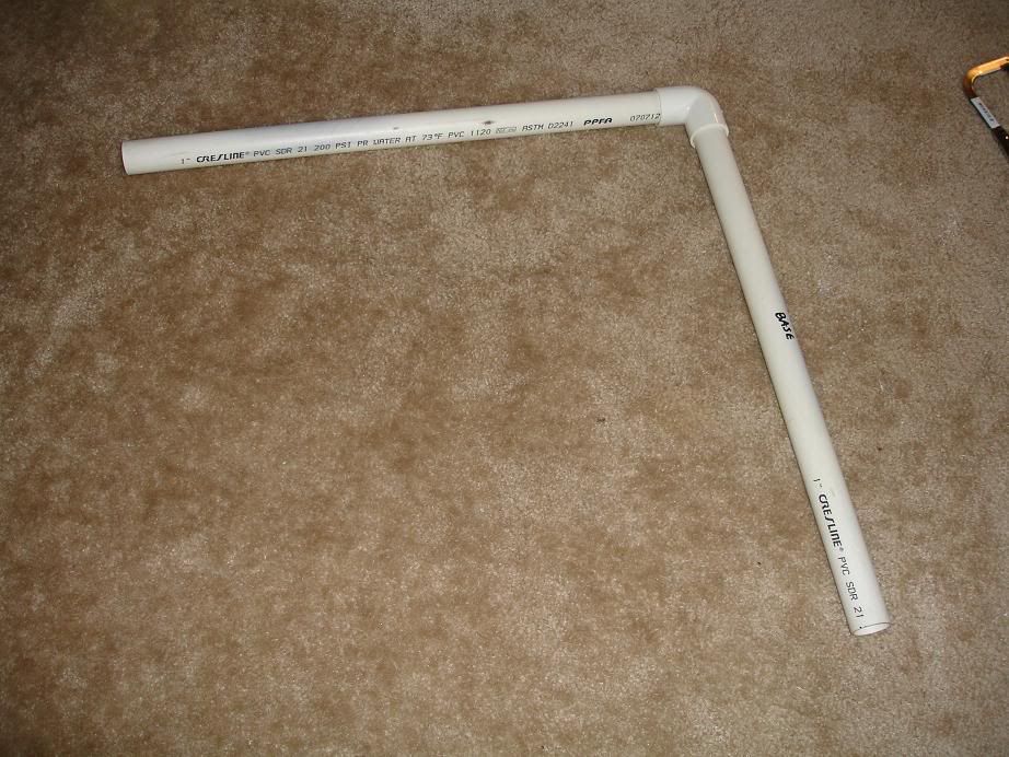

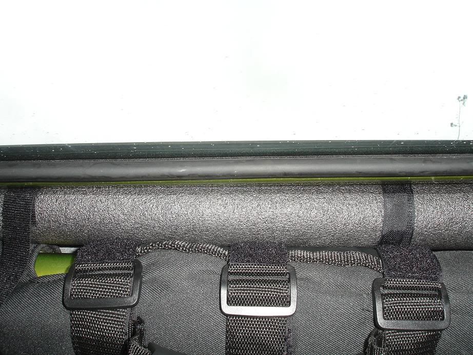

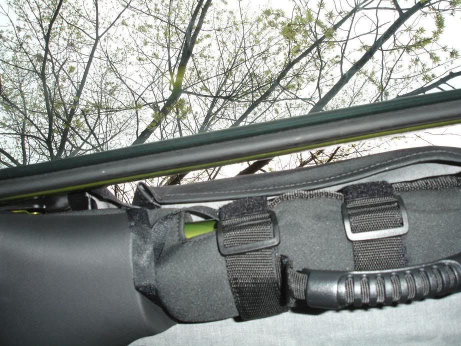

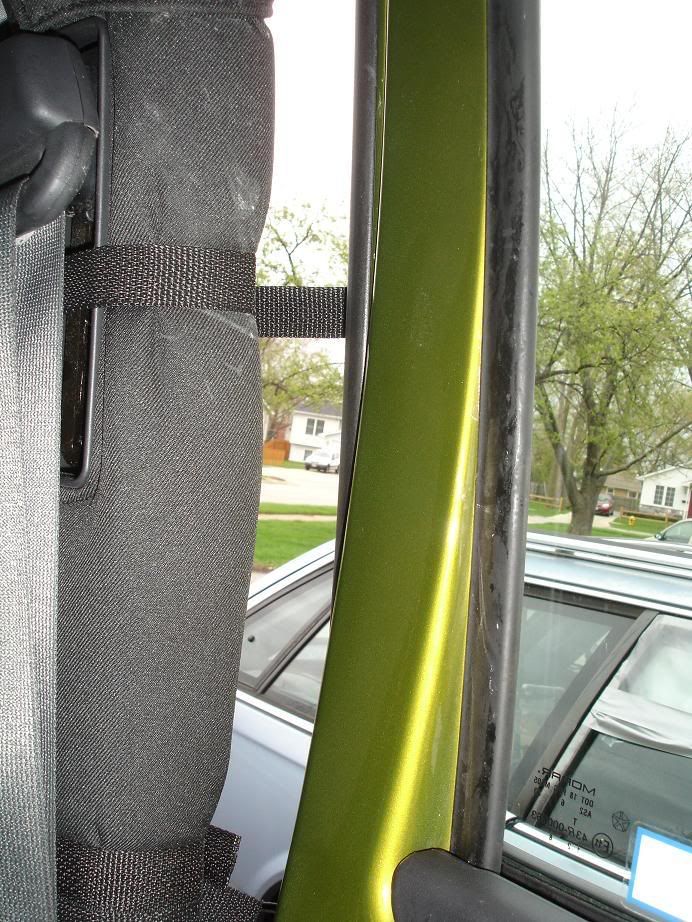

this was my fix for the gaps. Parts cost under 25 bucks. Didnt turn out too bad for being in a pinch.
PVC Skeleton
With the Insulation
Side of door frame
Above door frame
