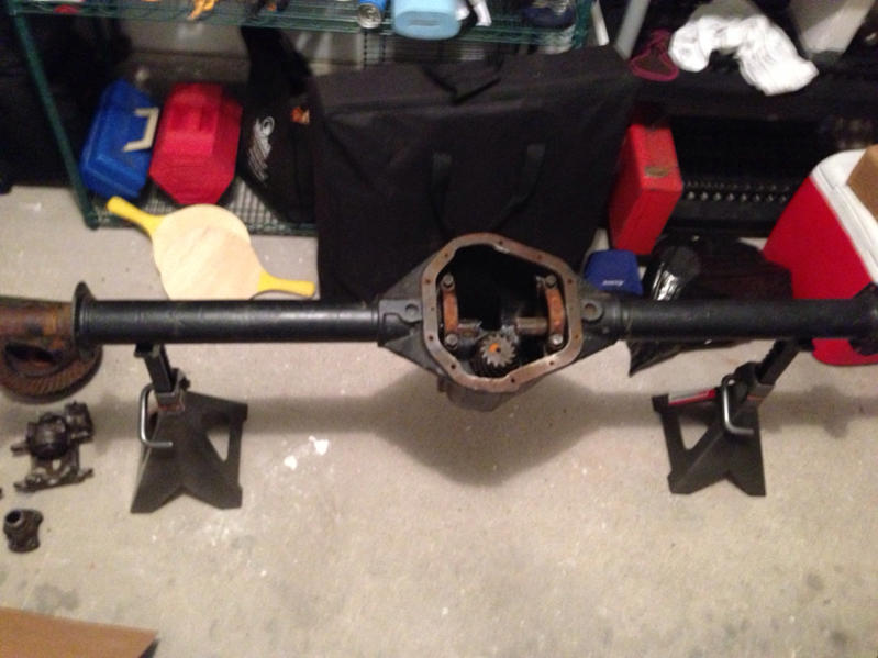

Ok so it's about that time that I venture in to the world of one tons... I picked up a Dana 60 full float rear out of a 1979 f250! This is what I bought:
What I am doing now is telling you that I've never done this before and have been reading posts upon posts upon threads upon websites about this stuff and I have a migraine! I have a welder for the truss and the brackets and I have a facility to put it together... I want to get a grocery list going and also want ideas about what I need to get and what I need to do and wanted the help from people that have done this!
I need tires and want to go UP! I was going to do it with my d30 and d44 but figured this is the best way to go! And it sounded like fun! I'm in the process of finding a d60 front out of a 78-79 f250 or 350.
I want it to last and be great! 5.38 gears are an absolute and I want eaton lockers! Everything else I need feedback and help!
I will tell you right now my first concern is the fact that I've read that my rear end is a 30 spline vs a 35... Should I be trashing this rear and getting a 35 some version?
Please help me learn and get this grocery list down so I can build some bad ass one tons.
Links are good too to website and different things but bottom line is I want to know what people are putting in these bad boys and how they are making them work!
Thank you in advance!

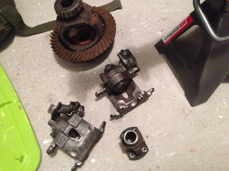

Having an issue finding and choosing rear disc brakes and rear hubs... Any thoughts?
Also I want to have the 8 lug pattern but want to have the electronics for the tone ring, esp, bad and so on. Also I want the parking brake!

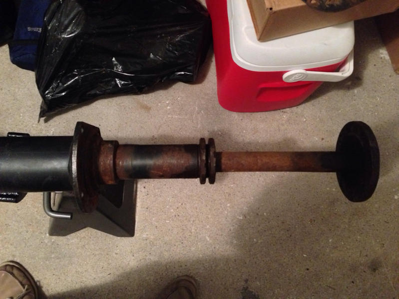

I would not use the factory hub on a dana 60, it is really a weak link. If you are going to all the work to do a 60 put in lock out hubs. They will allow you do disconnect the front axle for every day driving saving you some fuel and takes some wear and tear off your driveline. Should you break something up front you can also disconnect the hubs and drive on it. You can replace a shaft much easier with the lock out hub as well. Dynatrac has tone rings for 60's and I think ballistic fabrication does as well.
parts mike, solid axle, spydertrax, ballistic, mb call dynatrac, I have bought individual axle components from them.. I doubt you are going to like the prices you are going to find for doing the rear. You really want to go full float on the rear to keep from bending flanges on the axle shafts. That will require new hubs, bearings, and shafts.
