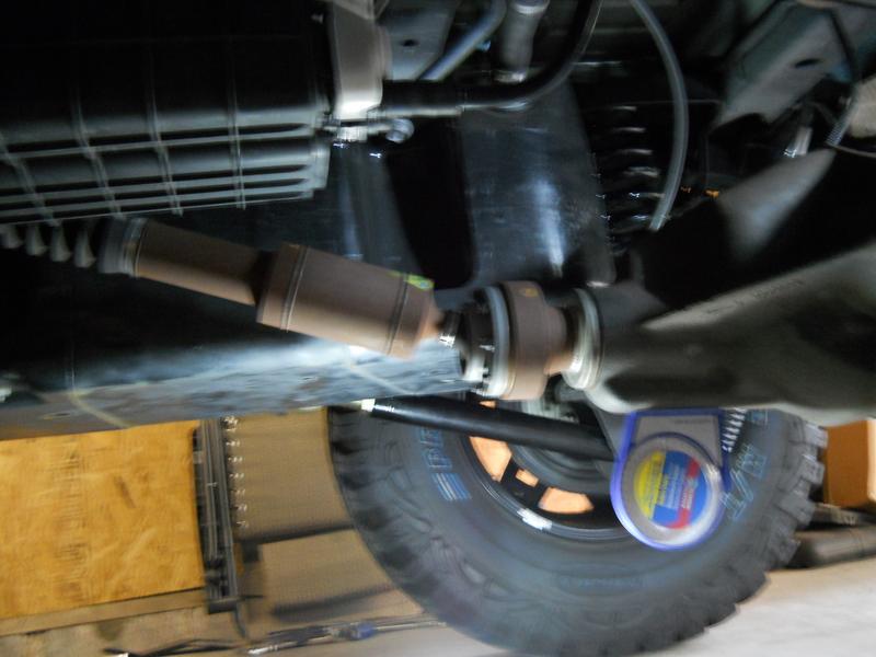

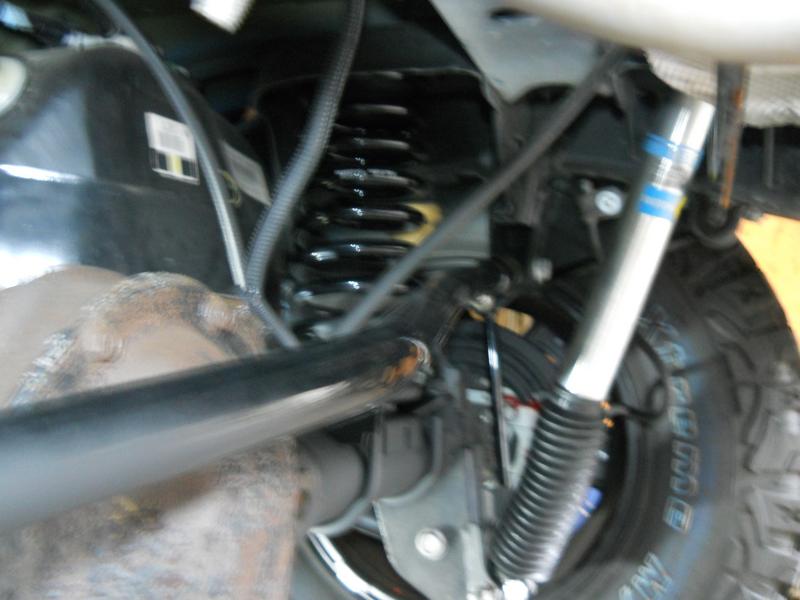

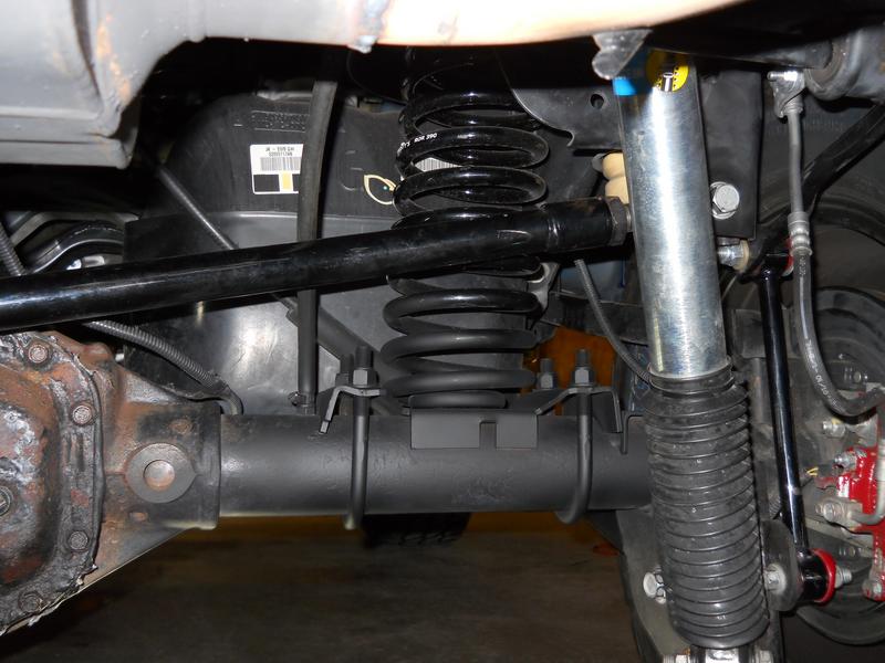

Sorry, i finally installed them and took some pictures, I still dont think my pinion angle is right. I set the front and rear to 6 caster, the front looks great, the rear looks terrible, it cant be right. Also it looks like i need to adjust my rear track bar or maybe the JKS perch needs moved out towards the wheel.

U need to raise the rear pinion so it points at the transfer case. There should be no angle at the joint where the driveshaft bolts to the axle. U have to lengthen the upper arms to fix it. U want the same angle your shaft is at, on the pinion as well. Where u have the angle finder..
