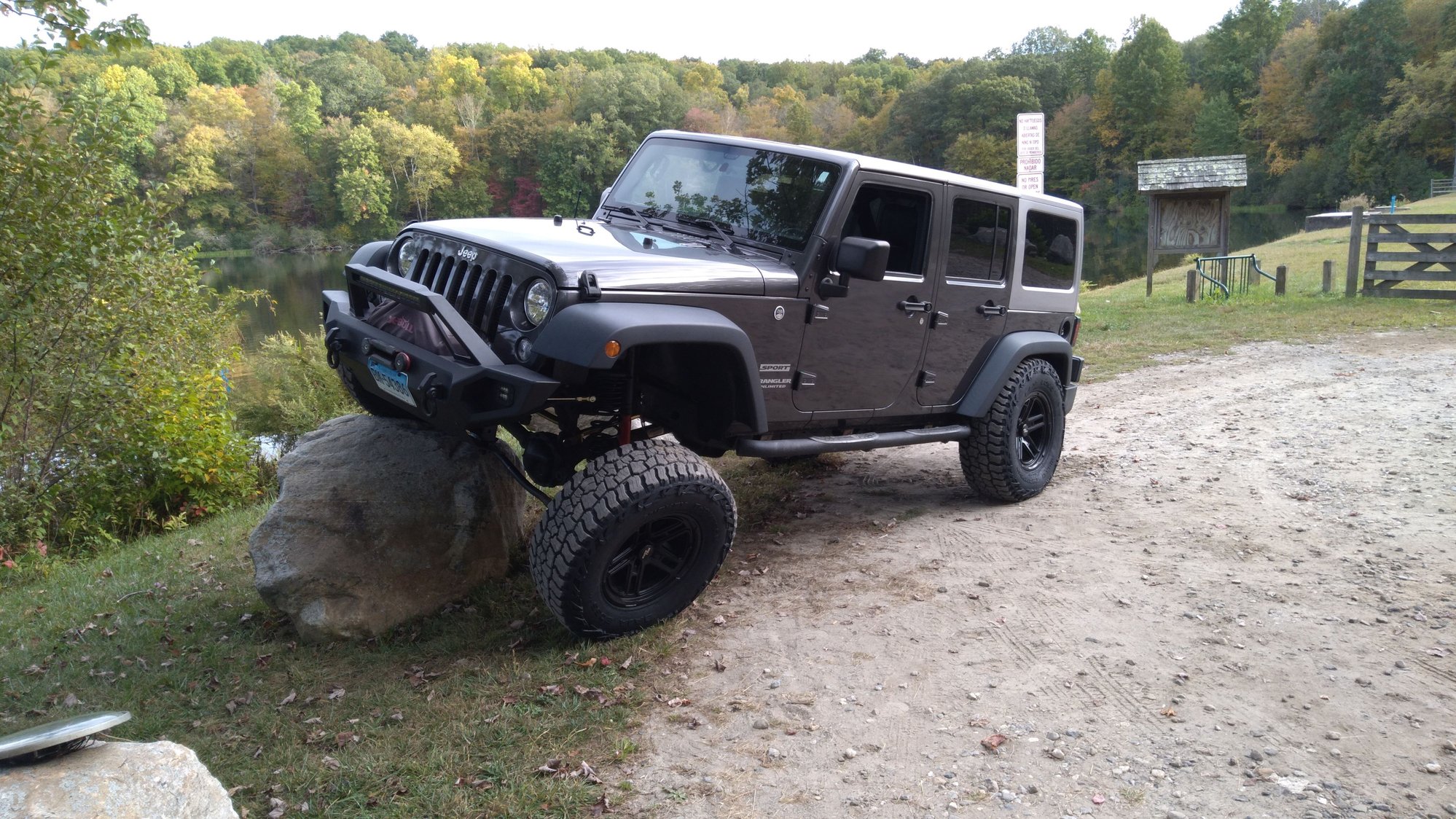

Well, I got a bit carried away, and still have to install my flat fenders, inner fenders and sliders, but I'm very happy with how things are working. I have a winch bumper, 13,500 lb synthetic winch, 2.5" Metalcloak lift, which gave me about 2.75" of lift. The reason I decided on Metalcloak is because, unlike all the other kits I looked at, this one ADDED about 3" of travel ( 11.5" shock travel). The kit called for the exhaust spacers so that the front driveshaft didn't interfere under full droop. I ended up putting in an Adam's driveshaft because I really needed the extra space. Rear droop is insane. I put in Truetracs front and rear, 17" Rocktrix wheels and MT 35 x 12.5" Baja Boss tires. I've had it offroad a couple times and I'm loving the Truetracs. I took it over some descent size rocks on a climb and a bit of left foot on the brake kept tires from spinning, even with a tire in the air.
