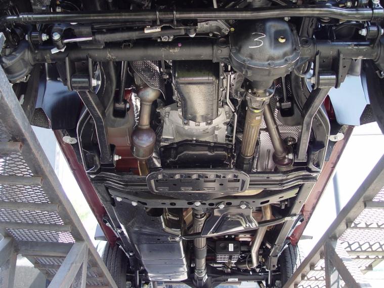

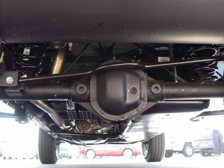

Alright guys I bought used. Instead of having 3,000 threads asking different questions I figured I would roll it all into this one. THANKS in advance for all the help. I have called the stealership and was told they could only tell me the options available for that year and no build sheet. PLUS it is used and came with a lift so who knows what the guy did. That is what I am trying to figure out.
Here's what I have .....
2010 JK Sport Unlimited (appears to have factory hitch job on the back)
I believe I have a Dana 44 rear and a 30 front... but I need confirmation please. I've attached pics that look similar to what I have.
To begin with....
Can you confirm that I have a 44 rear and a 30 front from the pics?
If I have a factory hitch is it a done deal that I should have at least 4.10 gears in the rear end?
If it's a Dana 30 in the front and no mods have been made, what gears do I have in the front?
The higher the number on the gears means more low end (off road) capability and crappier highway performance right?
I have 35" tires.... if that setup is correct, is it enough to push those tires around without causing damage to anything?
Off road I will be doing mostly light trails with the occasional small climb and axle deep mud pit.... is what I have sufficient for that without causing damage?
THANKS SOOOOOOO much in advance. I wanted to be educated.... gotta start somewhere.

Go to jeep.com, make an account and enter you VIN. It'll show you everything that was originally installed. you do have a D30F/D44R.
