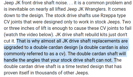

Yes, I have been through that link more than several times in the past hence the question, cuz I'd submit that most folks replacing their front DS are putting a DC shaft on. You may say that isn't right, but I'm questioning why it is just about everything you find on the market as far as front driveshafts for a JK is a DC shaft.....even on Tom Wood's site -
https://4xshaft.com/collections/jk-jeep
And in their description of their front DS products they even say this -
And the initial answer might be "that is why you need adjustable arms", but that then would take me back to there's no way to point your pinion at the TC without running such low caster it would suck....even with an aftermarket axle with additional caster. (I realize I'm running in circles)
I'm not trying to argue, just get to the bottom of this cuz I know in a perfect world yes, with a DC DS that pinion should be pointed at the TC, but hardly anyone has their set up like that and most are still running a DC shaft. I also know very few folks are running aftermarket axles with extra caster. I've got 10* caster built in on my front (running ~5) and the pinion still isn't pointed directly at the TC. My DC shaft seems to work just fine. In fact, I've never run across anyone saying their DC shaft was causing issues. Just trying to get to the bottom of it all.
