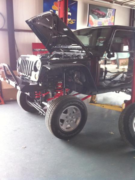

Hopefully will have mine close to finished tomorrow!! Just picked up my 41" iroks today!! I went with the 6 la teraflex with adjustable coil spacers! Still alot of work left though! Pic with the stocks on her!
Good luck with your build! Set your budget and add another 50%!!
