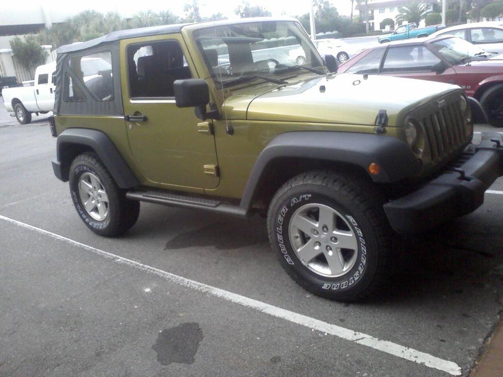

This is before I got a lift and bigger tires, 285/70-17 Dueller A/T's. No rubbing, but I never had it off-road. Daily driving you should be fine for sure.
