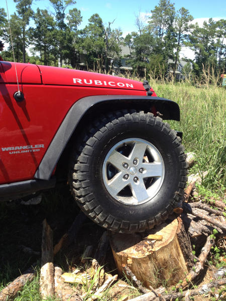

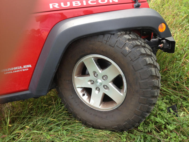

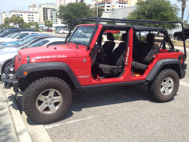

I have the Teraflex performance leveling kit and 1.5" wheel spacers on my JKU with 35x12.50 BFGs. You will have to trim the fenders and the pinch seam if you are going to do any serious off-roading. Or you could use longer bumpstops. You will be fine on the highway though.
