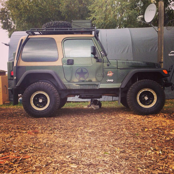

Just trying to get the awsome factor in like I had in my old jeep, One thing I don't like about jks is that they never look tall unless you go nuts to the wall. My old jeep had everything in it and I loved it. But needed a new project, not sure what I can do to make it have that look dad I want one of those factors when I drive down the road

I prefer the look of "Cjsmith4"'s JK myself.
