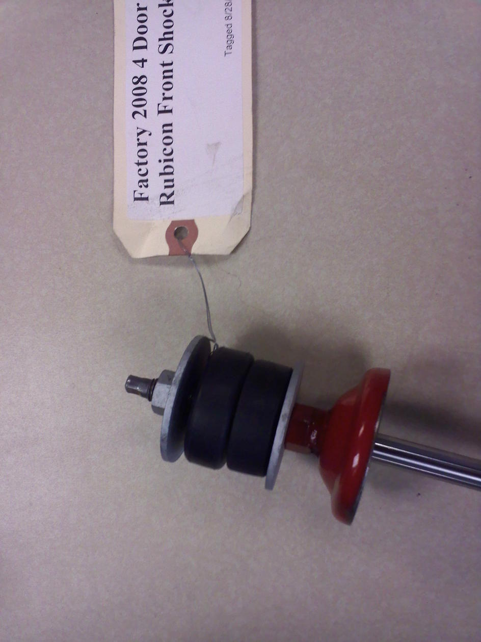

Here's what stock setup looks like. I know when I took my shocks out, my top bushings/washers disappeared on me. Thanks for the call.
Mine dosen't looking like that at all.
if i remember correctly, your factory shocks should have 2 bushing on them, like shown. if not 2, any bushings at all?
