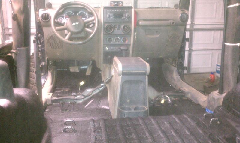

When I did mine I just left it there and went over it. I've had no problems with the liner comeing off.
