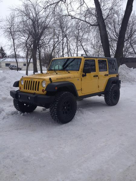

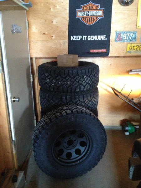

315/70/17 GY Duratrac's here. They measure a little over 34" mounted. Love em. Would definitely recommend them. They have been fantastic in the powder and hard packed snow on and off road but probably not an issue in Florida! They are an aggressive looking tire but extremely quiet and handle great on highway. They are probably the lightest tire in this range as well. Weighed 60lbs each.
The 16" Duratrac I believe is an "E" rated load range where as the 17" is a "D". The 16" will ride rougher then the 17

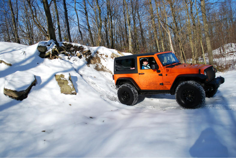

Go 15" it will save you even more. Just do your research on which 15's fit a jk. Discount tire direct has a list. 35" km2s were only $240 a piece

Dang $240 a pop! Im sold!

Just be sure that the particular 15" wheel you want will clear the JK brake calipers. Discount tire direct was very helpful there. But yeah it's all personal preference for the looks too. Personally I love the look of a big tire on 15" wheels, makes the tire look bigger. And i think 18" wheels make 35'a look like 33's. but that's just me
