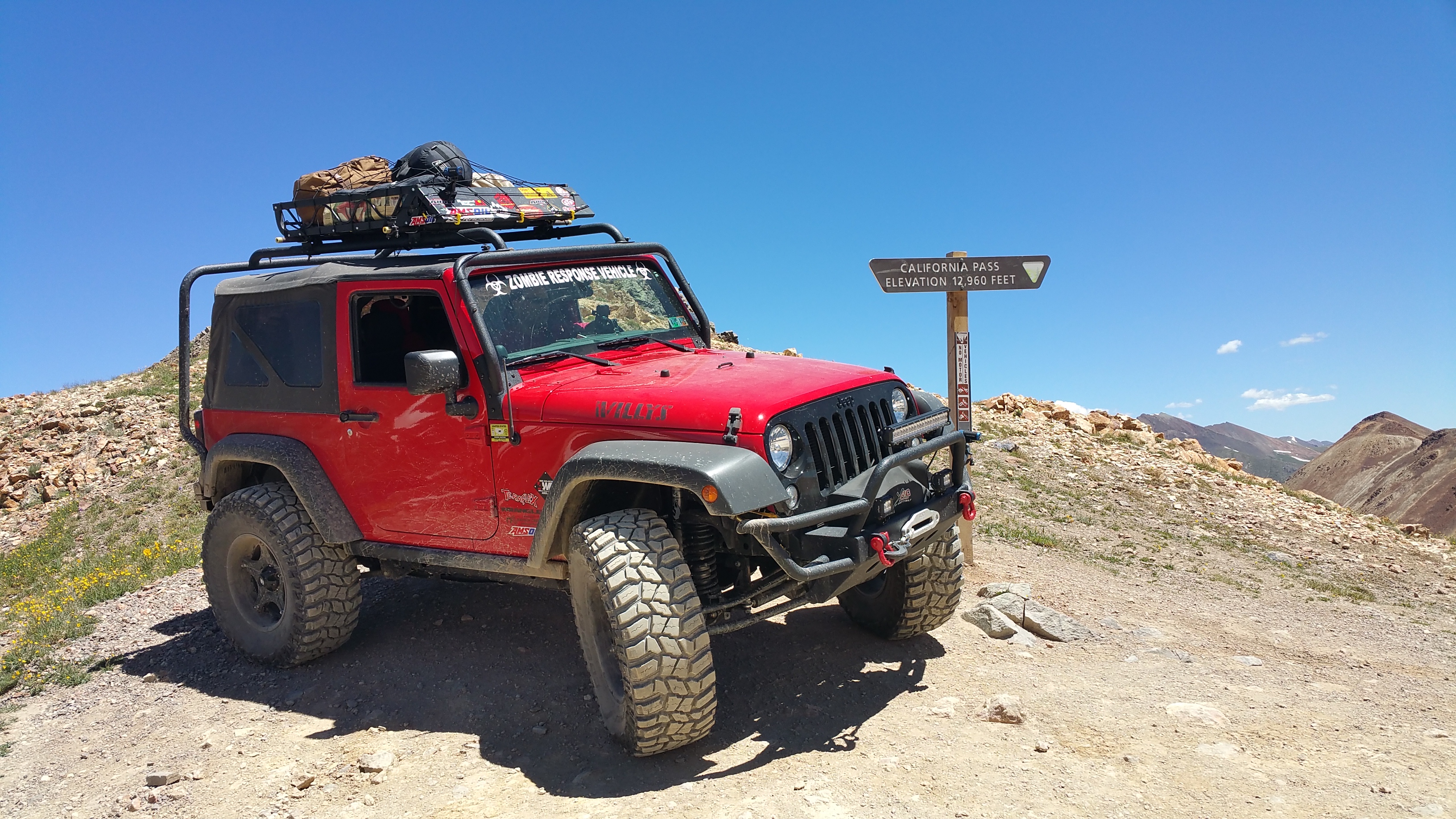

I built my JK for 37" tires after exhaustive reading across multiple forums. I have one thing I will tell you... In Ouray/Telluride/Silverton and at 13,000 feet.... I thought the engine was failing. I was in low range, 1st gear, holding it on the rug and it would manage around 7-10 MPH tops on the steep climbs. But then I'd get back down off the mountains and it ran just fine and normal. So as you see from my build, 4.88 gears are great everywhere but at the highest peaks. Now don't get me wrong, I made it... it could always keep climbing.... but there are times where your giving it all it has and there just is no more. But it keeps climbing. Slowly.
This year was 14,000 miles since the build, around 1,800 miles were off road. I have not touched since the re-tighten party on a mountain top in Colorado where I discovered that half of the fasteners had worked loose when we heard a thump in the steering. We screamed everything tight and never had to touch it again.
