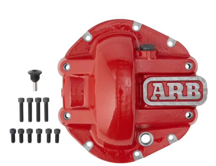

How did you determine how much oil to put in?

np Rob . I do that from time to time as well. But, that is the reason I asked cuz obviously that logic with an ARB cover would be detrimental -
But, I could still see someone run across that logic which may work often....and just keep pouring it in. Was curious if OP had looked up the Rubi44 specs or not.

I actually did look up the capacity before I filled it, which for the front is roughly 1.4 qts. After draining I did a good rinse with brake cleaner, then let it sit for about 20 minutes. Using the squeeze bottle lube, 75-140, I’m pretty sure I added around 1.7 qts inadvertently.
After driving it today it looks to have stopped leaking as there’s still fluid in the diff but nothing dripping.

Y, that is why I asked, and when capacity is 1.35qt, another 20+% is probably enough to do it. It's kinda of a rabbit hole, but also interesting to go down the YouTube rabbit hole of Banks videos about diff covers and gear oil flow. That ARB cover is really well designed and also probably a bit less forgiving, by nature of design, to being overfilled.
