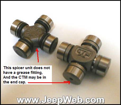

Where do you greese the driveshaft?
Old Mar 10, 2009 | 04:17 PM
tambil68's Avatar
Posts: 629
From: Kissimmee, FL
If you look in the u-joint, you should see either a grease nipple or some use a recessed??? grease point. That one is hard for me to find, but its there.
