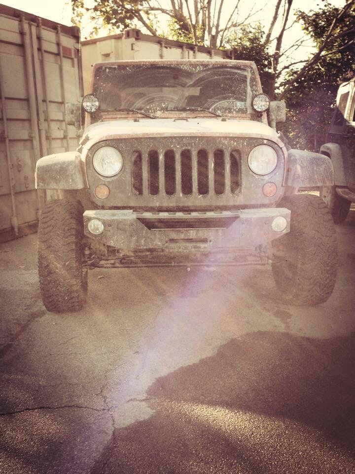

What is the point of posting a picture of your jeep?
