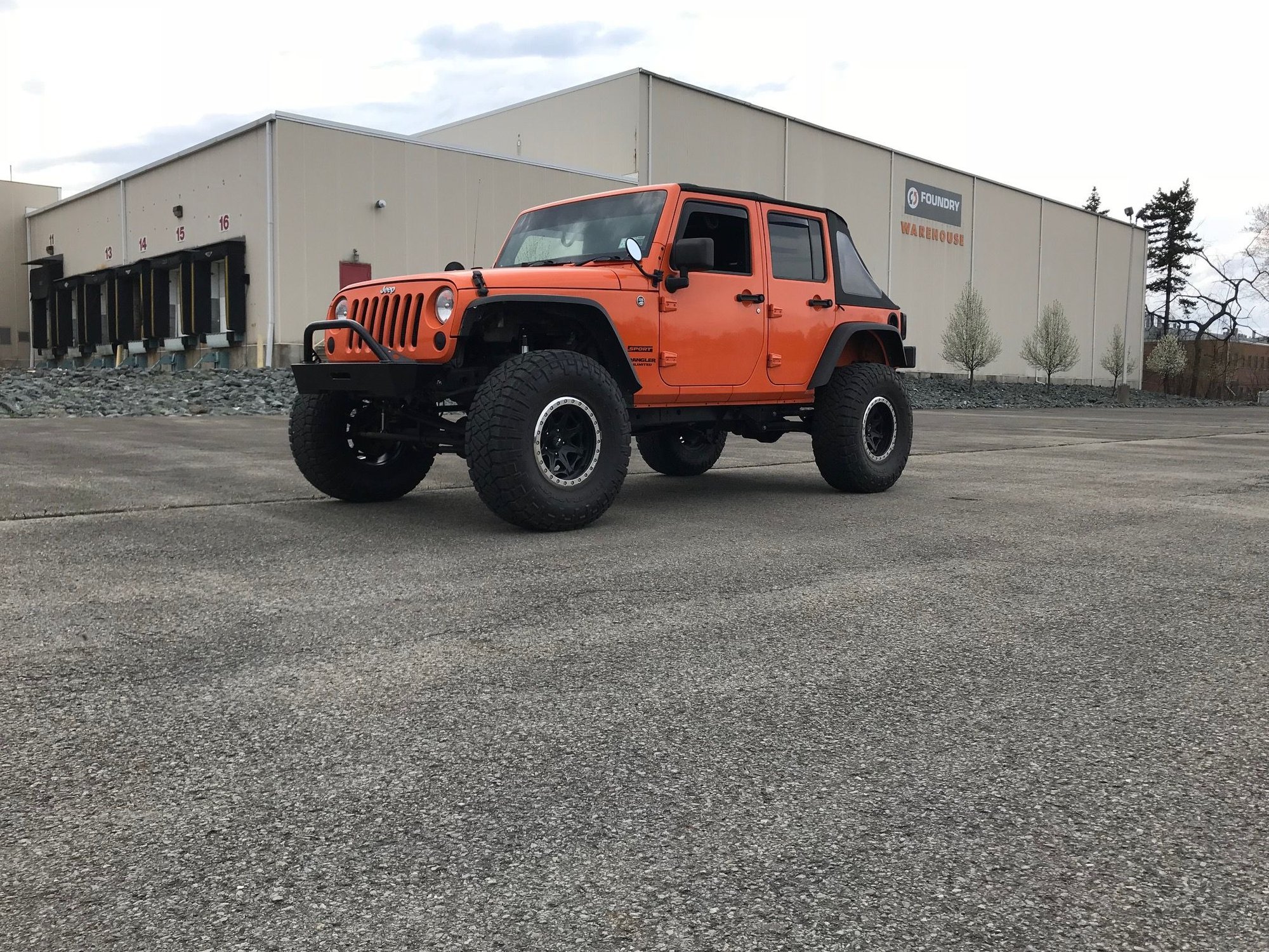

I am looking at the DV8 882 beadlocks. My question is they come in 17x8.5 with a 3.95 backspace and -20mm offset. How will this sit with a 315/70/17 Duratrac? Will it stick out past the wheel well? I have a 3" lift on as well.

There's more to take into account there. The factory wheels are typically 7.5" width VS new wheels being 8.5
Back Space measurement doesn't change with wheel width like offset does so all of that 1" in width would be in addition to the math you've already done. So the new wheels would be 3.3" farther out that stock wheels plus the additional tire width.
OP, we have the same wheels on a Jeep in the parking lot which has 37's and MCE fenders. It is a test mule for our new long arm setup.
What are the specs on the wheels you have? Do you have any pics from the front?
I'll take some, that Jeep went home with the boss man today so I'll have to grab some pics tomorrow if the weather is decent.

Here is a front shot:
