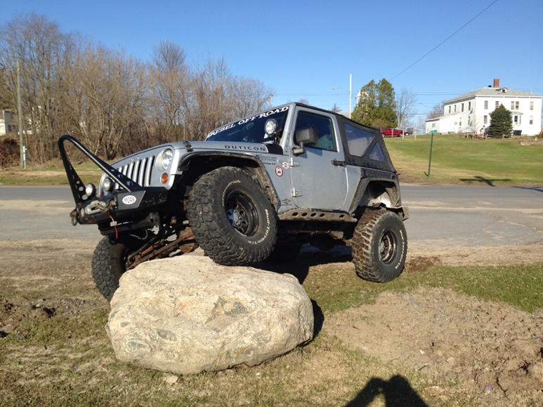

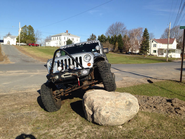

I have been putting roughly 3k-4k into her for the past two years it's slowly getting it where I want it to be
