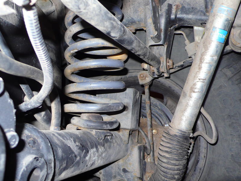

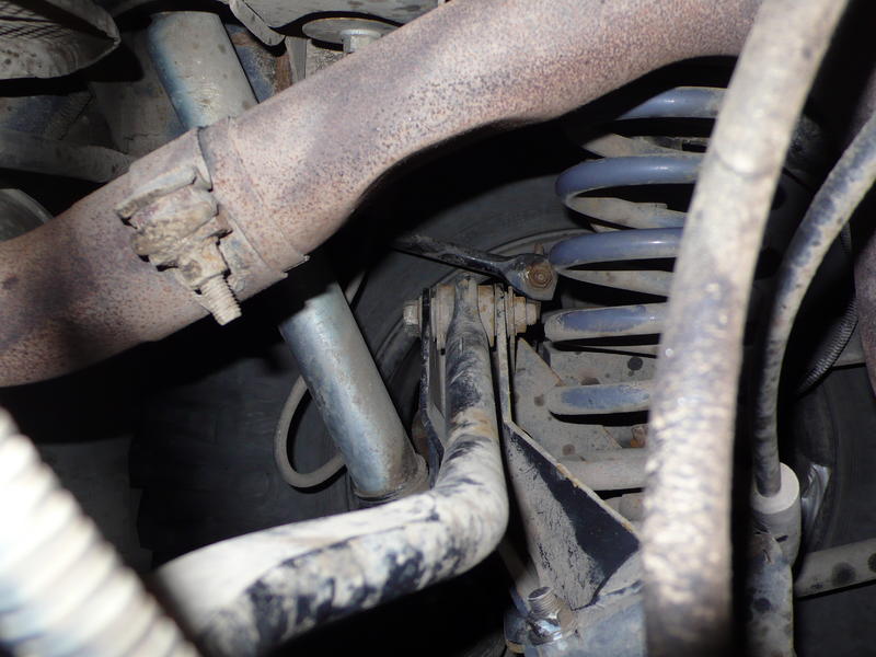

I was able to check a few things today. Pushed up on the rear bumper and found no play nor heard any sounds of movement with the shocks. The AEV kit came with a geometry corrected rear track bar tower and new track bar which I assume would take the spring hitting the track bar into account.
Took a few pics. The springs are bowed and driver's side spring is very close to the tracbar tower bolt,probably within 1/2" but there are no signs of rubbing on either side of the track bar or sway bar end links. How bad is it to keep driving with bowed springs and should this be fixed?
Still stumped. Any other ideas?

its hard to see in the pic, but on the driver's side, how close is the coil to the inside of the track bar relocation bracket? looks like it is almost touching.
edit: never mind, reread your post.
