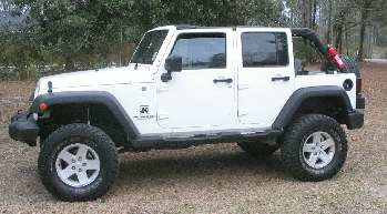

4in Superlift / bilstein shocks $800 shipped from Northridge couldn't be happier, all alighnment I did was re-center steering wheel. Got about 4 3/4in up front and 4in in back after it settled.

Notice he (Happy 4" Superlift post above....)DOES have a 1" BL as well...so he's solved the stuffage issue properly.
