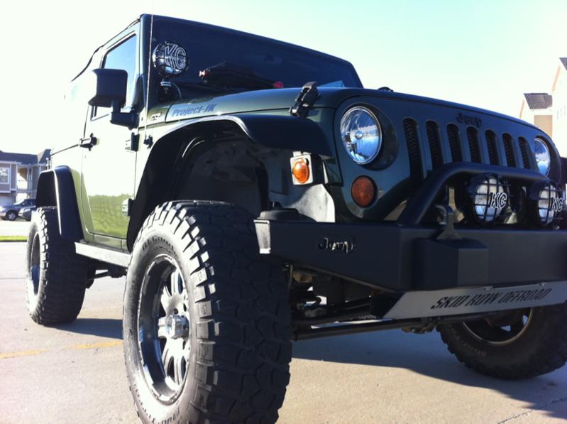

I'm not sure what you would need, but with the backspacing on those wheels, you should be alright with running a 12.5 wide tire. You could possible have some
Rubbing issues, but it mostly depends on the amount of lift/backspacing/tire combo. I am currently running a 2 1/2 rubicon express lift with American racing 17x9" punisher rims and 33"BFG KM2's x 10.5 wide. I have no rubbing issues at all. My tire specs are 285/70/17. My tires measure to 32" with a tape. Hope this helps!
