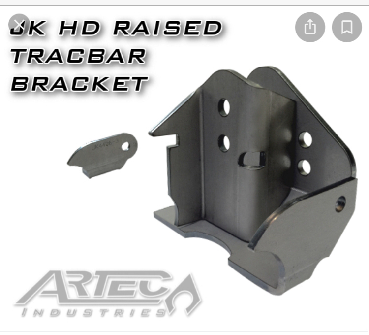

We can't figure out where the heck peice number 3 goes. The websites directions are worse then ikea and I haven't heard back from them . Can anyone help

The sway bar bracket goes on the driver side. I’ll take a pic of mine if you need and show you.

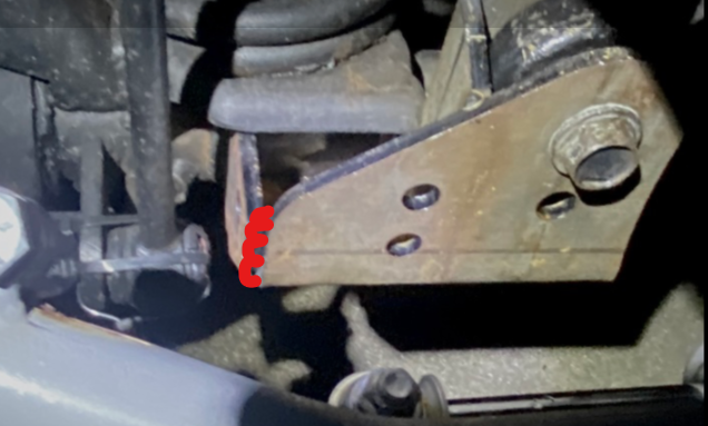

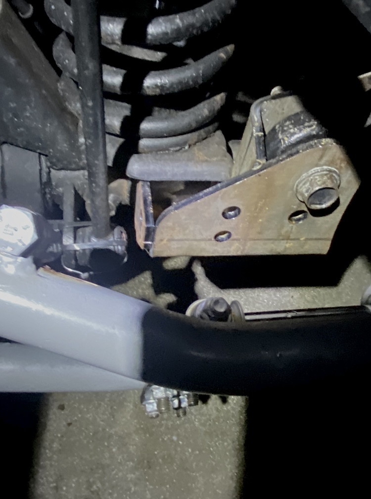

Well we couldn't figure it out in time so he welded part 1 and 2 . After he left I later realized what it was for when putting it all together along with reading your replies lol ...
On the bright side even though it's very tight, i can still get a nut and bolt in there, just not the OEM one... I'll be hitting ACE hardaware in the AM for a lower profile but/bolt. It's zip tied today.. also need to spray it black
I will say the bracket is BEEFY, Thanks for everyone's input on this vs a bracket that attaches to the OEM causing stress on both
not sure if your pic is the fully welded pic or not. But you’ll want to weld a bead on the front edge by the sway bar link.

I hadn't looked at the pic closely, but agree. Sv_dude is talking about right here -
