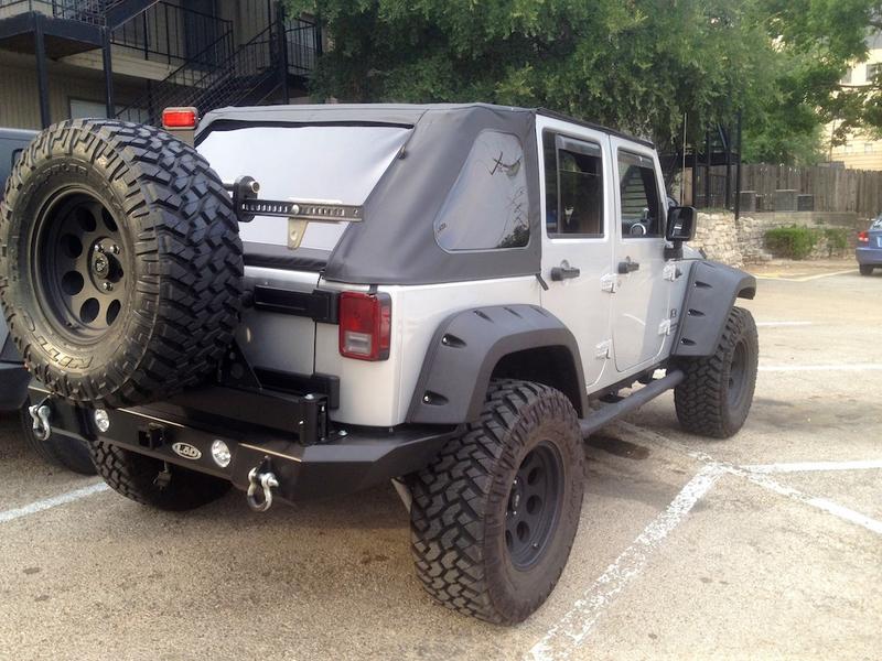

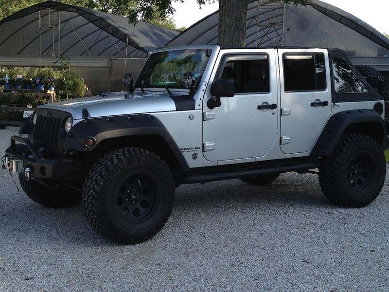

I would stick by 17" wheels as well, I bought my Pro Comp 7069's in 17's an love em, they look just right when you match them with a tire size twice as big like 35's, and they give more options for sizes to begin with. I mistakenly went with like 31's at first, then upgraded to 35's after like 2,000 miles, i have no complaints... 3 of the thumbnails are with my new 35" Nitto Trail Grapplers, the other is with the 31's with no lift kit
