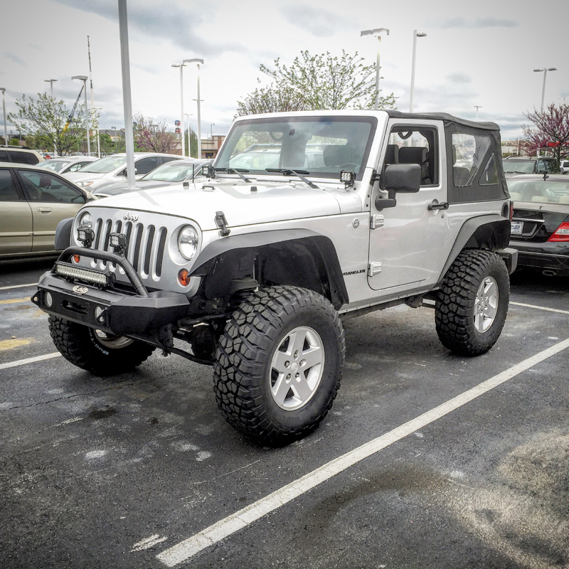

I have a 2010 Sport and I am running a 3.5" lift with 35" bfg km2s. Of course I have the 3.8 with the 3.73 gears now. I am looking at changing out to a 4.88 or a 5.13. What do you guys think? Would I be happy with those or do I need to go with something different?
