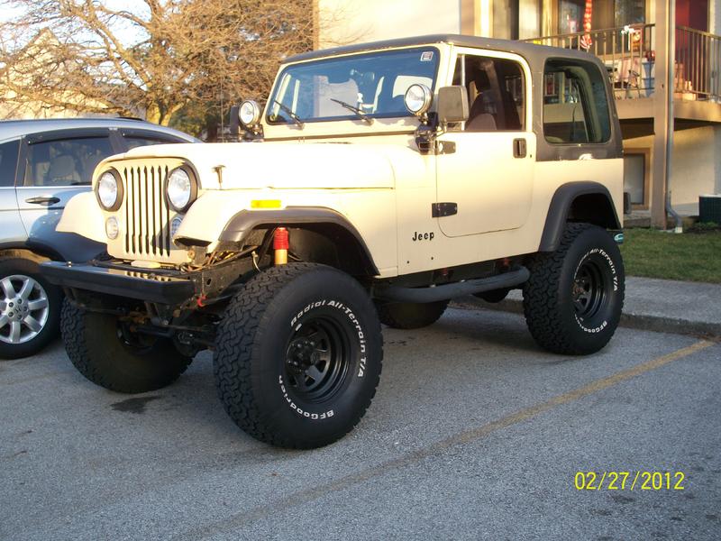

I had done the same to my 92 YJ, I replaced the hood, side fenders, and the grill with 84 CJ parts. If you go that way you'll have to drop in a CJ radiator because of the location of grill. I dont know if a TJ will work. Most CJ and YJ body parts are the same except for the front of the Jeep. Doors and tops work together. Best of luck.
