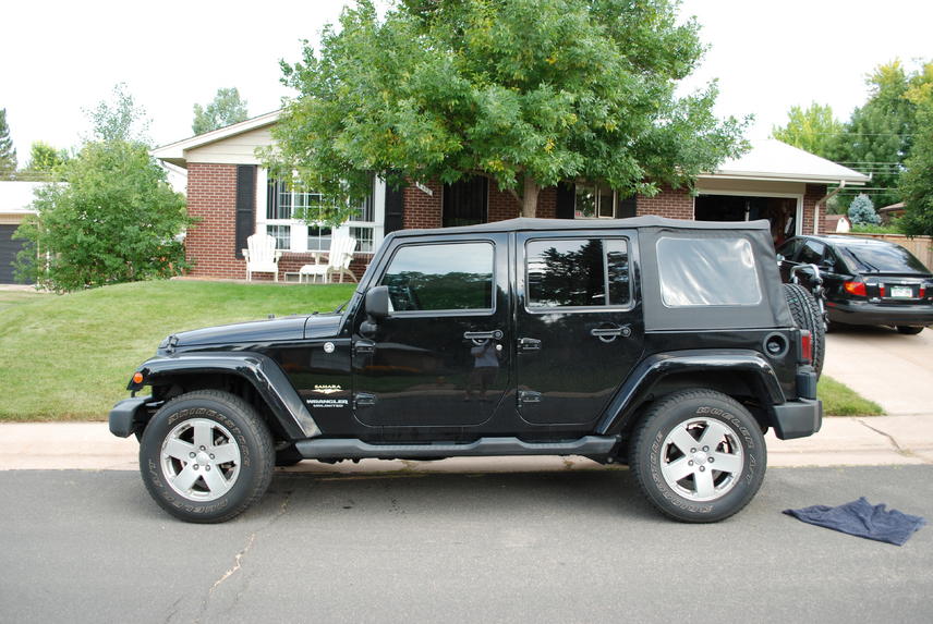

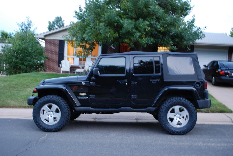

I'm running a 2.5" TF Coil/Shock w/ 295/70R18.. i"ve posted this a few times before, but these are slightly smaller 34.6" vs 34.8", compared to 35s and slightly thinner 11.5 vs 12.5.. still gives me the look, but cuts down some on weight/drag.
Here's some teaser pics
