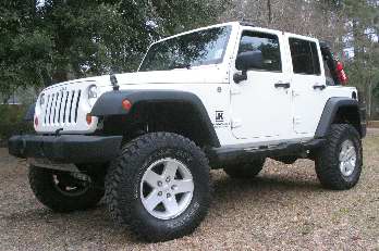

I have the a 3.5" (2dr) skyjacker kit and I am very pleased with its performance. I would recommend it to anyone, it rubbed the fenders a little bit at full flex but I put a 1" body lift and haven't had a problem since then. Good Luck with your JK.
