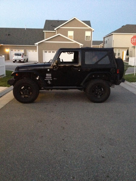

I have the Tera flex budget boost with 19/59 rubi Jku spings and red shocks on my 2dr. Gives it's about 2.5" lift and then I cut my stock fenders I'm running a 295/70/17 wheel and tire with spacers
