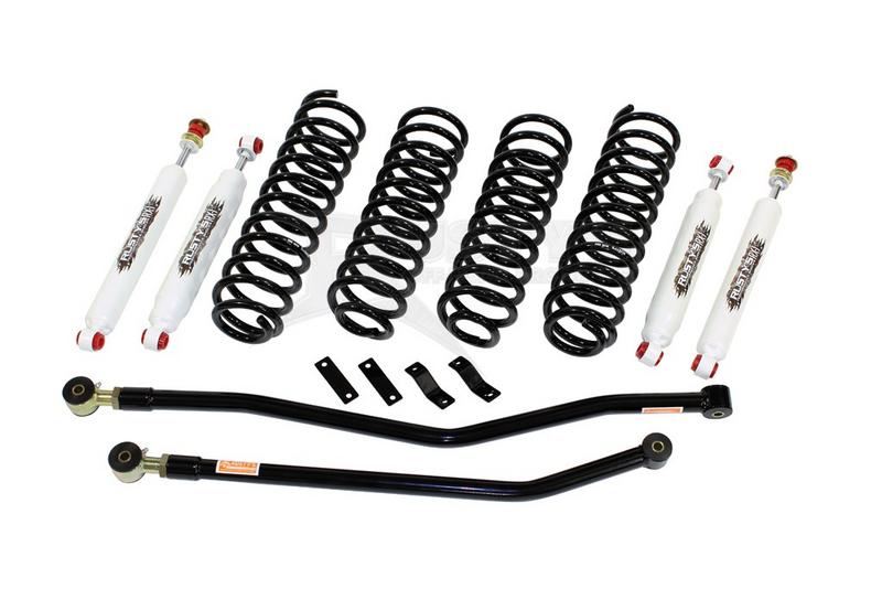

It is a "Basic Kit" from what I can see on their website extended length swaybar links are not included. You really need to address this...Rusty's has them as do a number of other suppliers.
There really isn't much to this kit...however, the adjustable track bars are a nice addition.
KIT INCLUDES:
• Front Coil Springs
• Rear Coil Springs
• Front Adjustable Track Bar
• Rear Adjustable Track Bar
• Front Hydro Performance Shocks
• Rear Hydro Performance Shocks
• Brake line extensions

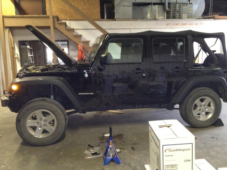

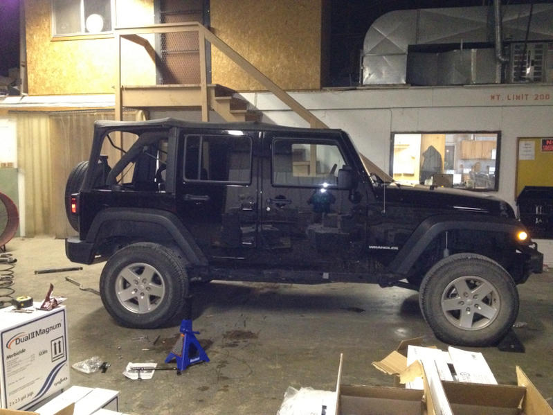

Here are some pics.
