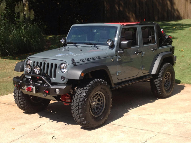

Everything is always personal preference or many companies wouldn't stay in business to compete if there was only vanilla. But... "I" think BDS make quality stuff but way too stiff/rough ride for me. I have used the BDS 4" lift before and wasn't as happy as I am now with my 3.5 AEV lift. Metal cloak is also nice with the 6 pack shocks but is a bit pricey. If it's for the bride, go AEV. It's the best road worthy lift and very strong and sturdy off road. 3.5" AEV will net a bit more height if you don't add bumpers and winch. Here is mine on 37"s
