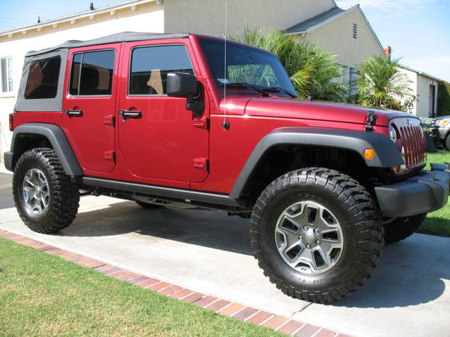

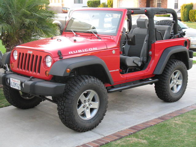

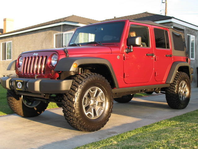

Teraflex 2.5 coil lift..........about $450 with shock adapters...... Millions have gone this way......
This would be a great choice.
