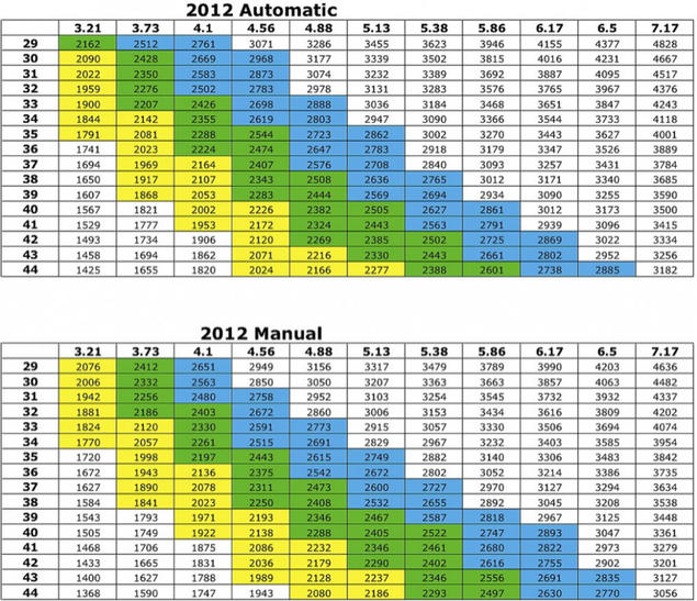

Most definitely don't waste your money regearing to 3.73. You want 4.10 or 4.56 with that setup. Here are the charts. From the way it sounds, I wouldn't bother getting a locker if you only do moderate stuff. no locker will get you "never in trouble" it's all about the driver. My open open jk keeps up with locked rigs a lot. Do lockers help in some situations sure. But you don't need them for forest roads :p

Can you say a few more words about the 3.73 being a waste of money? Do you say that just because of my potential future plans to add 37s? I like those charts very much. I built an excel spreadsheet that reproduces that chart for every gear (transmission, not diff) and for any speed (if anybody wants a copy, just let me know). As I interpret that chart, going from 3.21 w/32s to 3.73 w/35s will be a net reduction in gear ratio, yielding higher rpms for a given speed. So if I’m okay with the stock performance, a 3.73 will be better (by 6.2%). Sure, 4.10 would be even better (16.8% higher rpms for a given speed), but my assumption (right or wrong) is that improved acceleration will come at a price of lower mpgs. I know I’m simplifying things by neglecting the effects of the additional rotating mass at a larger radius. Including these affects involves more physics than I want to get into, call me lazy.

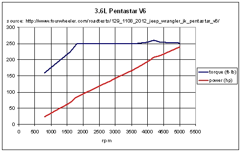

I also reproduced the 3.6L power & torque curves (I’ll try to attach below, hope it works). This curve tells me that I’ll get no more torque at 3000 rpm than I would have at 1800. According to the gear chart, at 70mph with the 3.73 and 35s, I’ll be 2081 rpms and the engine will be producing 250 ft-lb of torque. If I went with the 4.1, I would be at 2288 rpms, but still only be at 250 ft-lb of torque. So if the engine is producing the same torque, you should have no better ability to hold your speed against wind or up a hill. I’m hoping someone can straighten out my argument here. I must be missing something.

As for the torque curves, i don't really follow. You most definitely have more torque at 3000 than you do at 1800. I'm at work and didn't open the attachment, but for example, try holding a certain speed in 6th gear on flat highway or try to accelerate at 1800 rpms. Now down shift hold that speed and stomp on the gas.... make sense? The 3.6 and the 3.8 are definitely high revving engines compared to the 4.0
