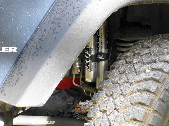

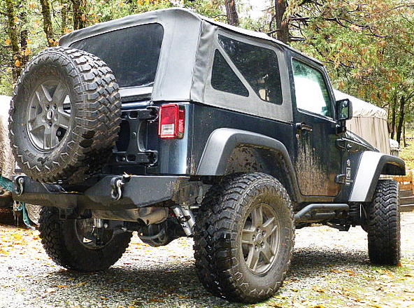

Can't beat coil overs. Top shelf. I started out with RC 2.2's, rough ride so Bilstein 5100's made a huge improvement. I recently changed those out for Fox 2.0 remote res shocks for longer travel and much smoother dampening. Also ditched the RC springs for EVO plush coils. Whole new ball game now. Fox remote res are awesome!
