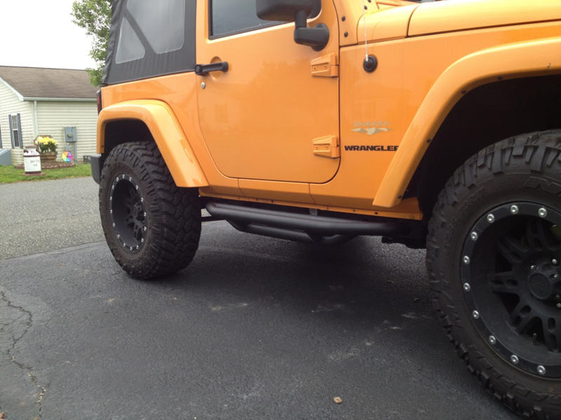

Spacers are spacers, pretty much. You can't go wrong with the Teraflex kits.
My 2dr with their level kit.
