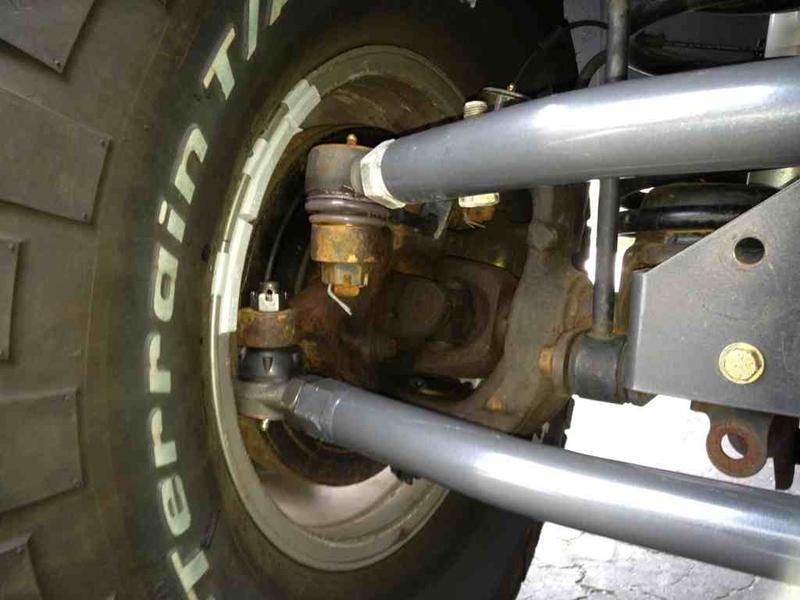

kjeeper10's Avatar
Vet Army
Posts: 3,440
From: CT
Synergy
