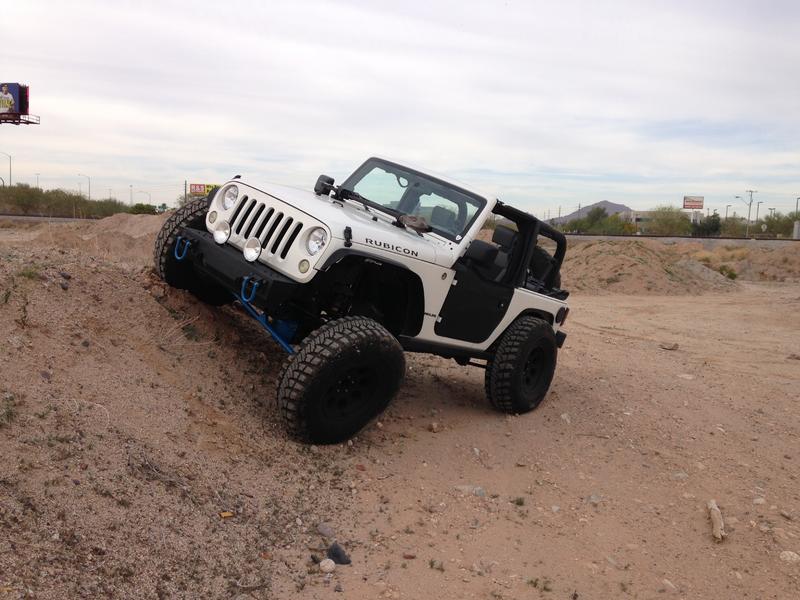

Flat fenders, 2.5" bumpstops and you can run 37's with 2.5" lift all day long. Just you wont be able to run long shocks to maximize flex, but you can run the standard shock extensions so you don't droop too far which is what will chew up your DS boots.
this is 2.5" teraflex coils and shocks and flat fenders. The rear shock mounts have been raised so it has a little more droop than the setup lifted above will have.
